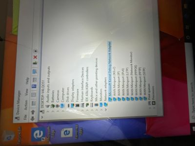

When I am in the device manager, this is what I see. I’m not sure which would be for wifi?

So sorry, this is what I am seeing.
I do not see that same Intel driver you are seeing.

What I highlighted in my image is not a driver, it is the actual device representation of the WiFi module by Windows 11.
