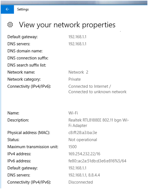

In "Network & Internet settings", i went to "View your network properties" and saw this:
I'm not sure if the "Not operational" status means anything beyond not being connected to a network, or if there's a problem with the card itself.
Thank you for the assistance!
