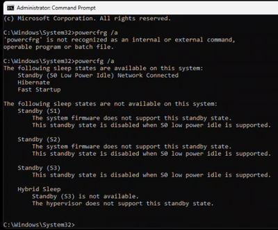

Please copy and paste the following command into Windows Command Prompt using Administrator mode.
powercfg /a
Should look something like this:
If there is a problem with modern standby possibly your BIOS setup has the option to use S3 instead of S0.

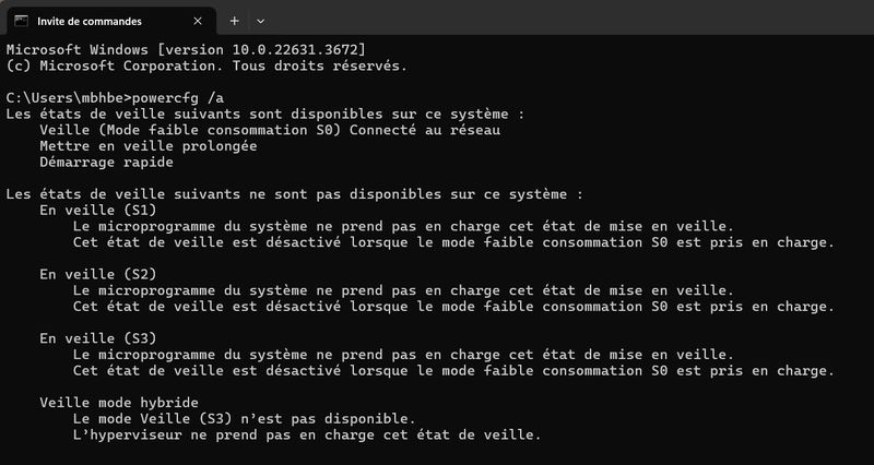

My laptop uses S0
