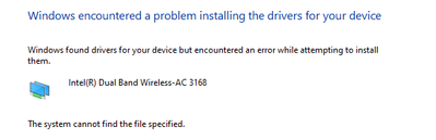

I checked the device manager and there is a yellow triangle on the wireless adapter.  This is what the properties tab says:
I tried to update the drivers on it and it came up with this error:
I tried to manually download and install the drivers and it has the exact same error.
I even tried to get the driver directly from Intel and when I tried to install from there, it says "a fatal error occured durring installation."
