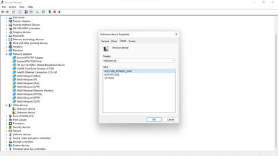

these
after installing the 3 drivers you advised, i went back to DM
The first unknown driver
the second unknown driver
OK...
One of them is the Intel Bluetooth device (the second one).
Unfortunately, Intel and HP no longer have the Intel 7260 Bluetooth driver available anymore.
Fortunately, I had saved both the last Wi-Fi and Bluetooth drivers Intel released for the 7260 Wi-Fi adapter because I have the same one.
Download, unzip and run the Bluetooth driver in the Intel 7260AC WiFi & Bluetooth Drivers.zip file.
SkyDrive - OneDrive (live.com)
The first unknown device you posted needs this driver.

The first one refused but the second  one was succeful
