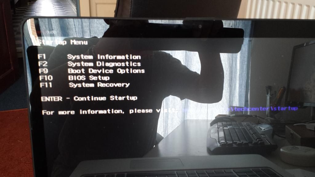

Press the power button. Immediately tap the Esc key. You should see a menu like in the following image. Select F2 for System Diagnostics to access the Advanced hardware diagnostics.

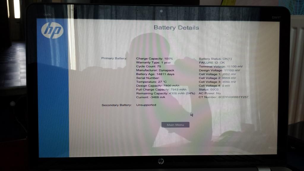

In the components section select battery and then you will see the following image screen. Run the check and if the results are good, go ahead and take the time to run the calibration. You can also see theBattery details  and that will tell you all about your battery.

That worked. it tells me that the battery has passed, and then didn't offer to let me calibrate. The Battery info page said:
Charge Capacity: 82%
Warenty Type: 1 year
Cycle Count: 116
Manufacturer: 11-85
Battery Age: 302 days
Serial Number: 01501 08/08/2012
Temperature: 23c
Design Capacity: 4400mAh
Full Charge Capacity: 3643mAh
Remaining Capacity: 3565mAh (97%)
Current 0mAh
Battery Status: ok (0)
Failure ID: ok
Terminal Voltage: 12465mV
Design Voltage: 10800mV
Cell Voltage 1: 4153mV
Cell Voltage 2: 4155mV
Cell Voltage 3: 4156mV
Cell Voltage 4: 0mV
Staus: 4060
AC Power: Yes
CT Number: 6B2LU08C83B15P
I don't know if that helps at all.
Thanks,
Pheobe

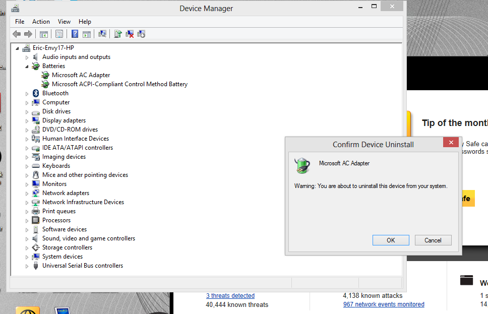

It does. I notice that your battery has lost about 17% of its design capacity. That indicates that you may have not been going through enough complete charge discharge cycles. We can reset the ACPI battery control method and that may resolve the issue you are having.   Invoke the Device Manager.  Expand the batteries device.
Right-click the Microsoft ACPI-Compliant Control method Battery device and click on uninstall.
Now do the same for the Microsoft AC Adapter
Both devices will have disappeared from the device manager. that is normal.
Now right-click and other device and click on scan for hardware changes. The operating  system will reinstall the devices.  Exit the device manager and Windows, then restart your notebook. Tap the Esc key to enter the startup menu. Choose F2 for System Diagnostics as before and choose Component tests and Battery. Run the battery test again. You may already have noticed that the battery is charging. Post your results here is your thread.
