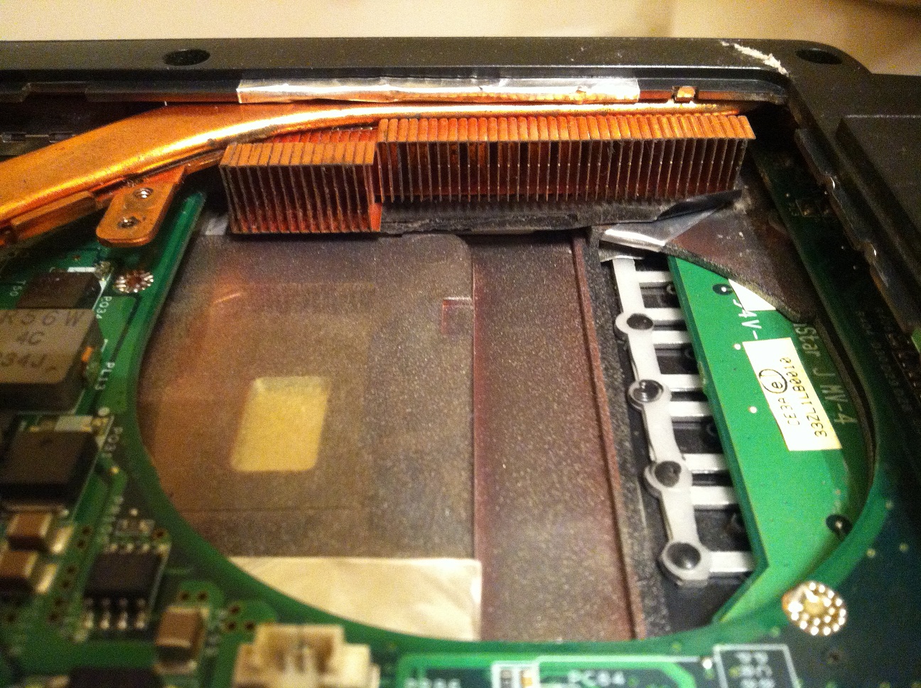

BEFORE - 1 yr clean home, non-smoking, no pets
AFTER
