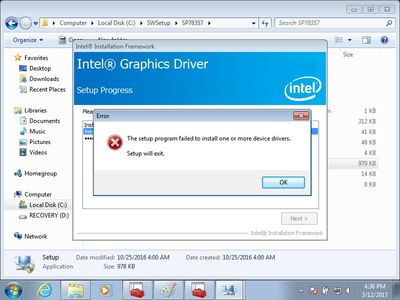

Doing it through Device manager did not help either - It says: That my device already has updated drivers.
Here is the print screen where I just run the setup after the file u sent me pasted into the proper folder

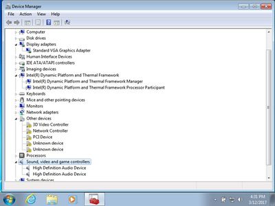

Here is my hardware showing in Device Manager: Devices2.jpg
I really feel it should be showing at lest my Intel HD 520 graphics and Nvidia graphics  in my device manager, besides it doesnt show my second 1 tera HDD. Its like my motherboard doesnt recognize these devices. But usually when i did fresh installation before, OS instatly recognized all of my hardware pieces even w/o drivers.
I went into the BIOS and there is lit almost no options to mess up with things except the boot option...The most limited BIOS I have ever seen in my life:(
Do u have any other suggestions ? 🙂
Sorry that didn't work.
You can re-read the post the guy did and see if you can modify the graphics driver yourself (though I am pretty sure I did exactly what he wrote down).
If you can't get that Intel graphics driver to install and recognize the HD 520 graphics adapter, you are dead in the water.
There is no point in going any further.
