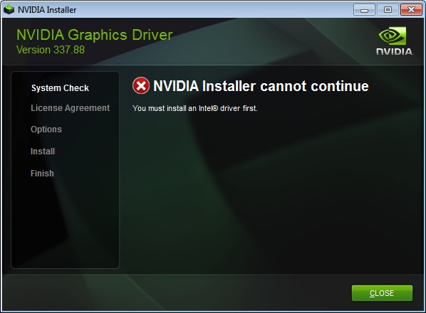

I recently bought an HP 15-022TX notebook (with NVIDIA GeForce 820M card) from Flipkart. I installed Windows 7 Pro 64-bit from DreamSpark and downloaded the driver for the card from here.
Now when I run the setup, it gives the following error -
undefined

Try installing this:
http://ftp.hp.com/pub/softpaq/sp66501-67000/sp66556.exe
After that and reboot windows then you could try installing your Nvidia driver again.

Hi:
If the driver Derek posted doesn't work (it should), then use this one...
https://downloadcenter.intel.com/Detail_Desc.aspx?DwnldID=23885&lang=eng&ProdId=3719

Thanks  and   for your suggestions. But it seems I've resolved my problem. I downloaded SlimDrivers Free from download.com and let it scan my laptop. It automatically detected the outdated VGA driver and downloaded and installed the appropriate Intel HD Graphics driver.
Anyways thank you for your support!

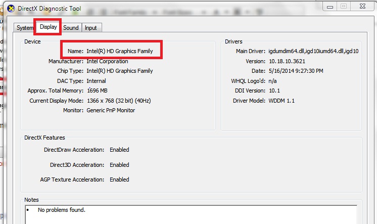

Hi,
I have intsalled NVIDIA graphics driver however it seems that NVIDIA drivers are partially installed meaning:
It is available under option from Device Manger
undefined
However If I run command "dxdiag" (through Winows button + R)it shows "Intel HD Graphics Family "as primary graphic device(below screenshot):
undefined
Any suggestion OR feedback for this behaviour?? I will be extremely happy if someone knows resolution.

Hi,
I have same HP notebook that nisargshah95 has.
Device: HP 15-022TX notebook
Graphics Card : NVIDIA GeForce 820M card
OS: Windows 7 Pro 64-bit
I hope this info. is enough and issue which I have raised has been understood to you.
Ekse I can give you more inputs.
Thanks,
Kamlesh lad.
The images showing on your computer is normal I mean since intel is built in but Nividia is delicated (not part of the motherboard or cpu) bad explaning i do apologize..
