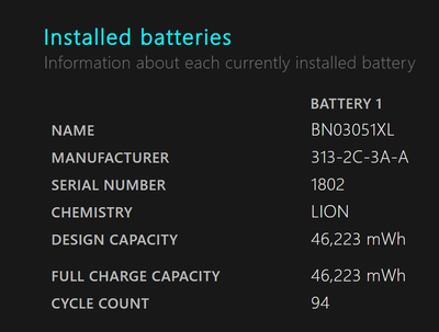

The location of your Battery-report file will appear as in the image below.
Double click the Battery-report.html file and select a browser of your choice as the app to open the file.
Now you will see the report.
You can print it if you like, or copy the text and post it in a reply in a thread you may have authored about your battery issue.
Your original laptop battery will also show the serial number and number of charge/discharge cycles in the Cycle Count. Mine is a replacement, so it does not.
This is the part of the report that will help you make an educated decision on replacing the battery.

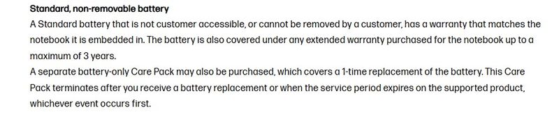

Do be aware that replacing the battery on your own does violate the warranty.
