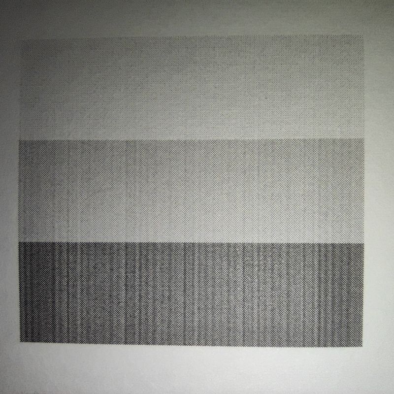

Recently I bought an HP Neverstop Laser 1000w. Unfortunately, print quality looks pretty poor with this device. See the attached example.
I also tried to print the test page.
Uneven horizontal lines are visible on test patterns.
Considering the fact that my printer is brand new, is this a normal result for this specific devise?
Thank you!

I tried to print the following picture:
Here is the result.
As you can clearly see, the black part is perfect and does not have any defects, while the grey areas consist of aforementioned uneven lines. If these lines were somehow caused by the imaging drum, they would also be visible in the dark area. Perhaps these lines are normal for the specific printer?
