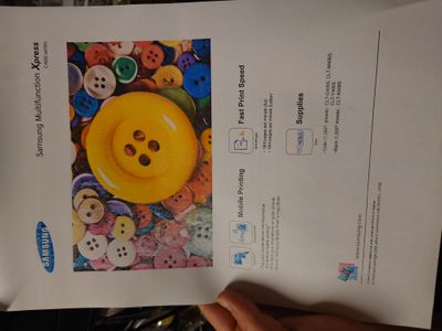

I had two C460W with different problems. I managed to solve the problem with one of the printers, it had paper jam in tray 1 because of a bad solenoid. To try to fix the other one I put parts from the now working printer. I have therefore ruled out problems with toner, drum unit, transferbelt and fuser. I have also tried to clean inside the machine as good as I can. It still prints like this. Anyone have an idea?

Thank you Gaya1239 for your fast and detailed reply.
Now I'm more confused than I've ever been. I've assembled the bad printer to try your suggestions and before I did that I put some duct tape on the bad solenoid to try to make up for the lack of rubber on the solenoid which I thought was the problem. I know this isn't a solid solution but I thought this would work until the new solenoid arrieves (so I can test your suggestions in the meantime). The thing is that when I started it it printed a perfect page, not blurry at all. But if I print more than one page there is a real paper jam but not in tray 1, the paper jam is now in the scanner unit.
Do I need to check in to the psychiatric hospital or is there a logical reason to this? 😅
