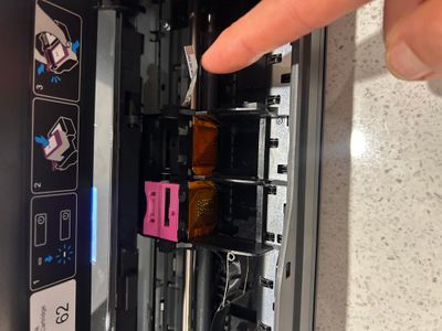

Replaced old Black cartridge which was registering as empty. Brand new genuine HP 62 replacement cartridge- printer throws CARTRIDGE PROBLEM- remove and reinstall ensuring correctly installed.
Old cartridge replaces nil issue- it just doesn’t have any ink to print.
Run all the suggestions- turn unit off, clean terminals, etc but same CARTRIDGE PROBLEM when trying to install new cartridge. NIL issue when re-installing old cartridge. It just doesn’t print because the ink is empty.
Have replaced colour and colour prints fine.
Device firmware is updated.
Seemingly unrelated, but you don’t know what you don’t know- there is a “tail” of white ribbon floating free on rhs of printhead- see pic. Is this normal?
I wouldn’t expect it would explain why the printer doesn’t accept the new but accepts the old cartridge though.
