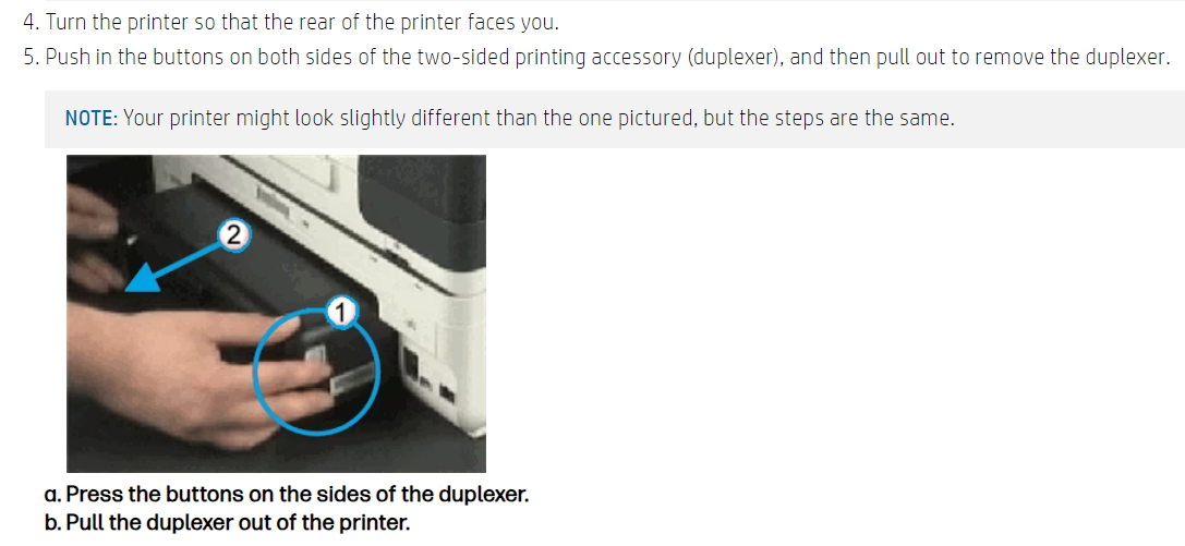

I just want to know how to get inside the printer to empty the excess ink that has accumulated in the ink well that captures the ink ejected when cleaning the print heads.   It is full and leaked when I move the printer to another desk.  Can the back panel be removed to access that "well" and remove the old ink - ie drain it out

I see that you are looking for information on how to remove the back panel on your Printer.
Kindly refer to the below image to remove the duplexer and that is the only part you will be able to remove from the back of the printer.
I hope this helps.

I know how to remove the duplexer - the only issue is how to get open access to the ink "tank" that fills when you do a clean print head maintenance.  I recently carried my HP 8600 to another room and it leaked ink all over a rug from that tank.  It is way back in the right corner and I wanted to be able to suction out whatever is in there to prevent this from happening again.
