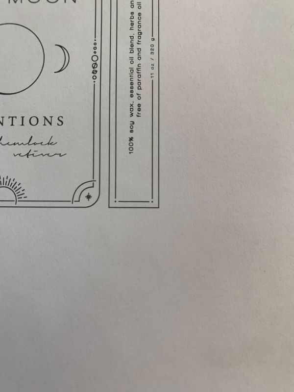

I've attached two photos to show the difference in quality. You can see in the photo printed from my computer the lines have very clear dot patterns whereas the one printed from the phone does not and looks nice and clean.
higher quality - printed from phonehigher quality - printed from phonelesser quality - printed from computerlesser quality - printed from computer
