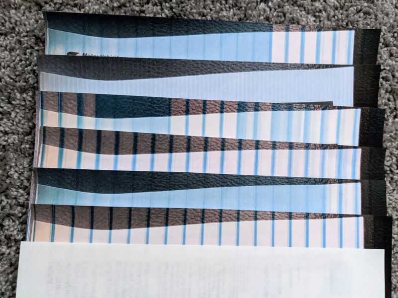

I received an email on October 13, 2020 with the following subject line:
Important: Cartridge Problem
HP has recently determined that you may have received Cyan (blue) and/or Yellow cartridge(s) for your OfficeJet Pro 6968 that may have a quality issue. We sincerely apologize for the inconvenience and are working hard to ship replacement cartridges to you within 3-4 weeks.
I'm not sure if any other cartridges are part of this issue. My printer uses HP902 Instant Ink Cartridges.
PS - This issue may NOT have been "solved".
PPS - I too tried "every solution know to humans". The issue has been ongoing for months on my printer. I'm guessing since late in 2019. I just don't do that much critical printing so streaks in my Cyan weren't an issue.

I have the same issue and it has been ongoing. I got that email, and just received new ink so I went ahead and installed it, but same issue. Very streaky. When I run the clean print head option the cyan, purple, and green are streaky. I have a blue heavy photo to print, but I can't! I tried yet another different cyan cartridge and had the same issue. Are they ALL defective???

Just installed the new Cyan and Yellow cartridges. They did not correct the problem. I ran Clean Smear and Clean Printhead through Level 3.
Just got my new cartridges and they did not solve the problem.
Two more test prints. One is a solid cyan box. The other shades of cyan.Solid Cyan.jpgShades of Cyan.jpg
@BlueCat58
That's unfortunate. This means that the issue is with the printer hardware. Please reach out to the HP Technical Support team in your region regarding the service options for your printer.
