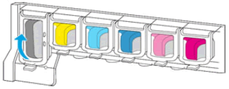

Resolve ink cartridge errors (02, 17, 363, 801 cartridges)
Resolve errors such as 'Cartridge Missing', 'Depleted Ink Cartridge', and 'Incompatible Cartridge' for printers that use HP 02, 17, 363, and 801 cartridges.

Remove and reinsert the ink cartridges
Make sure the cartridges are seated properly in the carriage.
  1. Open the cartridge access door.
    Opening the cartridge access door
  2. Pull a cartridge out of its slot.
  3. Slide the cartridge back into its color-coded slot until it stops.
    Installing the cartridge
  4. Repeat these steps to remove and reinsert the other cartridges.
  5. Close the door to the cartridge access area.
