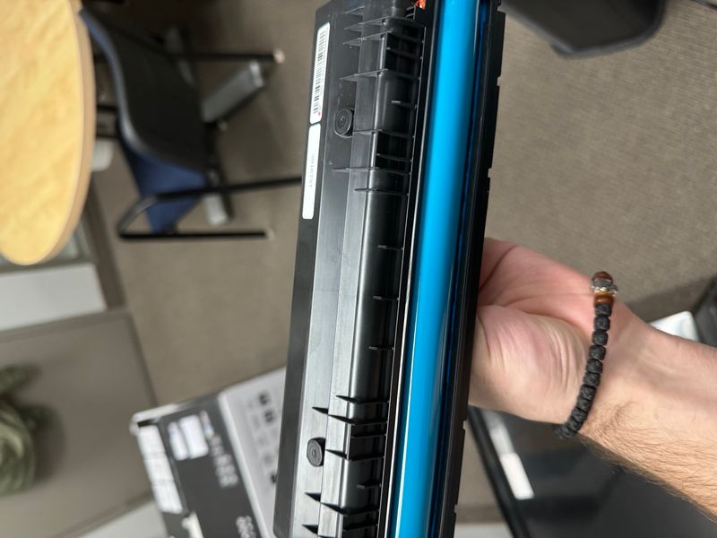

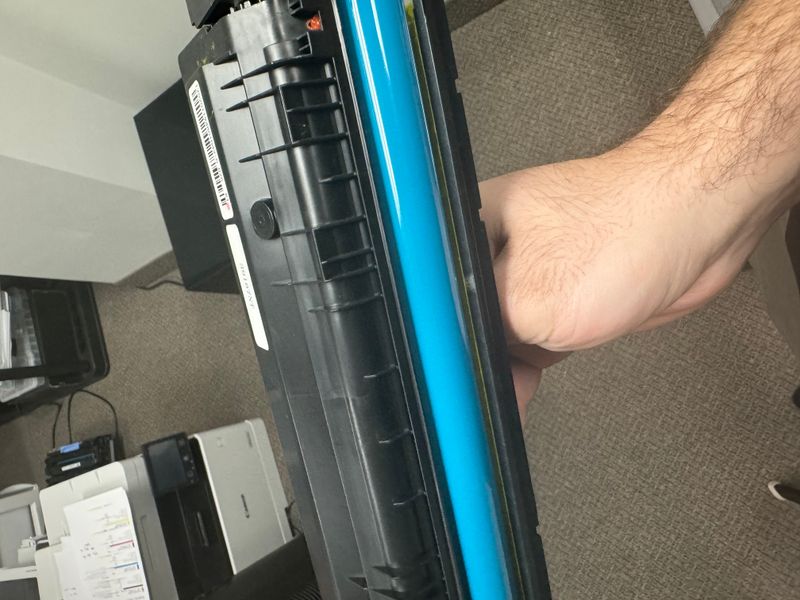

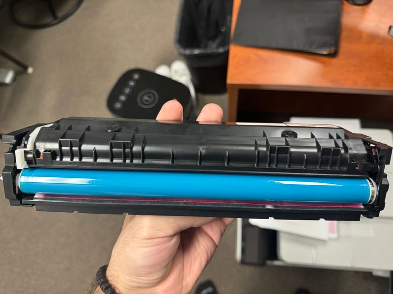

I recently purchased this printer and when I print color, I see horizontal magenta and yellow streaks that represent a pattern.
When I print b&w, there is no streaks.
Here are some photos of what it looks like and the toners.
I've tried many things and researched a lot, I've come to the conclusion it's likely I need to replace the toners (which is a bummer because they're expensive and it's still 90% full), but before I pull the trigger I would love some insight.
I also noticed these white marks on the toners. Could it be from that? Is there a possibility I can repair it instead of wasting and replacing, also should I fix anything in my printer to avoid new carts from being damaged.
1 REPLY 1
Based on the single color repetitive defects there is an issue with the magenta and possibly yellow toners. Not unexpected from a budget priced generic cartridge. See it all the time.
