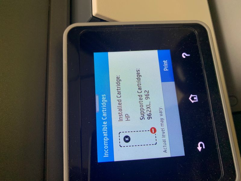

I have had the same exact problem.  HP OfficeJet Pro 9010.  I bought a new HP black cartridge - 962.  Same exact one as I took out.  It gave me the error that the cartridge was not compatible.  I returned the cartridge, bought another HP 962XL, tried that and received the same message.  I can't imagine that two cartridges would be defective out of the box.
I put all of the old depleted cartridges that worked back into the printer. After placing only the new black (962XL) cartridge back into the printer it showed the other three as depleted, and the new black one as not being compatible with this printer. I put the old black one back in, and repeated this process for all other colors. The same thing happened for all of them.
The old cartridges that worked were what came with the printer. Is it possible there is an issue using the "XL" cartridges. This is all our warehouse orders. I do not have the option to get the standard cartridges to check on this. The printer does list both 962 and 962XL on the printer door as compatible cartridges.
After doing my own research throughout this forum, it appears that this is a common issue with this printer using XL cartridges. If this is true, why are they listed on the printer as a compatible cartridge?
If it helps any, this is not the only printer at our company with this issue. Multiple people that have this same printer are having issues when it comes to replacing old ink cartridges.
Please see the pictures below:Error  when ALL new cartridges are installled.Error when ALL new cartridges are installled.Cartridge 962XL.jpgError when  only the new black cartridge is installed.Error when only the new black cartridge is installed.
