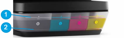

Step 1: Check Ink Levels and Refill Tanks
Low ink levels can affect print quality:
  • Ensure the ink levels in the tanks are adequate. If any tanks are near the minimum fill line, refill them using HP's recommended ink bottles. Avoid overfilling as it can cause leakage.
