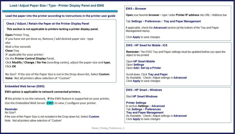

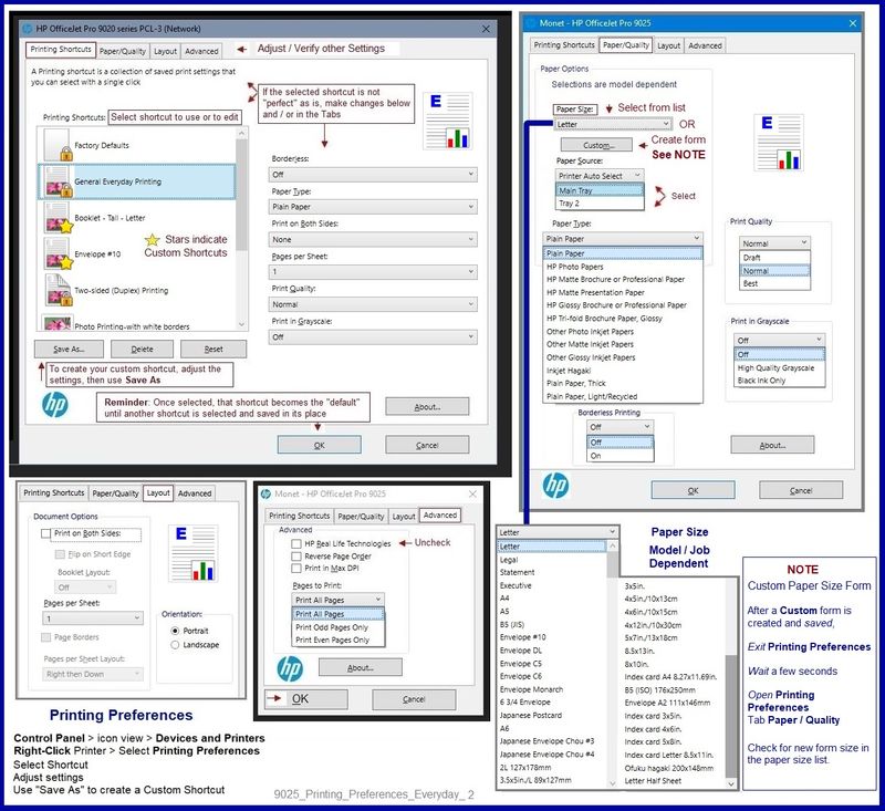

Next:
  • If the printer includes a printer display panel, select the paper size / type on the printer
Next:
If the printer is on the network and it supports EWS,
  • Use the Embedded Web Server (EWS) to adjust the paper size / type
Next:
  • Use / Adjust the "preferred" Shortcut in Printing Preferences to "Everyday Printing"
  • Leave "Everyday Printing" Shortcut selected (blue)
  • Save any changes > Click OK to save and exit

Printer Display Panel / Embedded Web Server (EWS)
Example
Retain_Printing_Preferences_5Retain_Printing_Preferences_5
Control Panel > icon view > Devices and Printers
Right-Click Printer > Printing Preferences
Example - Printing Preferences - "Everyday Printing"
9025_Printing_Preferences_Everyday_29025_Printing_Preferences_Everyday_2
