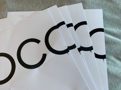

i use the hp officejet pro 7720 and print with a3 glossy photo paper (i've always used the same paper and no issues) suddenly the printers started smudging the ink as it spits it out,  it smudges in the exact same place every time, i've checked and there doesn.t seem to be anything stuck inside. just replaced the printhead too as was having issues with it streaking but this has been happening before i changed printhead. also leaving black marks all down the back of the paper when i print in a4

Can you make a scan and post here so the smudges can be seen ?

black lines on the back of the pageblack lines on the back of the pageinkk.jpg
The smudges on the front are they present when printing the same job on a plain paper? Looks like a paper issue to me.
The smudged on the back side are on the printers rollers, it will clean itself out if you print several empty sheets on a plain paper.

i've been using the same paper a while now and it's never happened so just confused, thanks i'll try that
it's only on a3 too so and don't have any plain a3 paper
