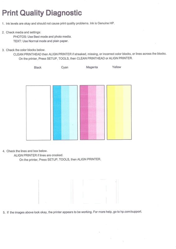

Thanks for your reply. I should probably have said from the outset I have already done those things several times. This is what the print quality diagnostic shows after I tried cleaning the print heads. As you can see, the colours look fine but the black appears empty, even though it is a brand new cartridge. I also know it is the correct type - they were all in the same box, changed at the same time, and fitted perfectly. I even fished the old black cartridge out of the bin in case I had muddled them up when changing! (I hadn't).

Hi @yatesyman,
Thanks for the update, and I appreciate the extra context, that really helps!
Based on what you've shared and the diagnostic page showing missing black ink despite a new, genuine cartridge, here are a few additional steps to try:
Run Multiple Printhead Cleanings
Sometimes one cleaning cycle isn’t enough, especially if the black ink channel is clogged. From the printer’s maintenance menu, try running the printhead cleaning tool 2–3 times (with a 5–10 minute pause between each run). Then print another diagnostic page.
Check the Vent on the Black Cartridge
If the vent on the black cartridge is blocked, ink won’t flow. Gently remove the cartridge and inspect the small vent area (usually on the top). If there's tape covering it (aside from the protective strip you already removed), gently peel it off. If the vent seems clogged, lightly clear it using a pin or clean cloth.
Perform a Hard Reset
This can sometimes recalibrate the printer:
Turn on the printer.
With it still powered on, unplug the power cable from the wall and the printer.
Wait 60 seconds.
Plug it back in and power it up.
Try a Power Drain and Re-seat Cartridges
Remove all cartridges.
Power off the printer and unplug it for 2–3 minutes.
Plug it back in, power it on, and reinsert cartridges one by one, starting with black.
Try a Firmware Update via HP Smart App
If you haven’t yet, use the HP Smart app to check for firmware updates. Sometimes ink detection and flow issues are fixed in updates.
