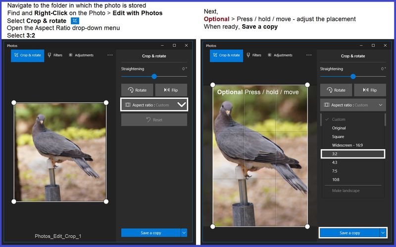

To help the photo better fit on your paper,
Edit the shape of the photo to match the shape of the paper
NOTE:  Adjusting the Aspect Ratio / shape of the photo won't eliminate the need for the larger margins
For example,
Crop / Edit to aspect ratio of 3:2 for a standard 4x6 inch print.
Example - Edit with Photos > Crop & rotate > Aspect Ratio 3:2
Photos_Edit_Crop_1Photos_Edit_Crop_1
