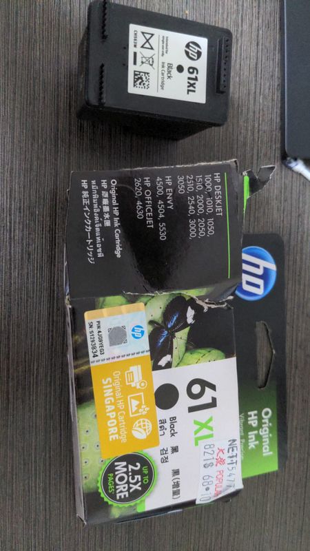

- I purchased this printer second-hand and it came installed with 1 colour (Model 301, CH562E) and 1 b/w cartridge (Model 301, CH561E). It recognized the cartridges that came installed and I was able to print documents without issues via Wifi. --> See photo for old cartridges
- The black cartridge ran out recently and I purchased an original HP Ink Cartridge (Model 61XL, CH563W) to replace it. The packaging on the new cartridge specifically mentions that it is compatible with HP ENVY 5530. I purchased the cartridge from a reputed chain retailer for electronics in Singapore (Popular Singapore). --> See photo of new cartridge
- However, when I installed the new cartridge (61XL), I got an error message on the printer screen 'Incompatible Cartridge(s) - The indicated cartridge(s) are not intended for use in this printer.'. --> See photo of error and of installed cartridges.01 Printer Serial Number.jpeg02 - Old original black and colour cartridges02 - Old original black and colour cartridges03 - New genuine original black cartridge  and packaging03 - New genuine original black cartridge and packaging04 - New black cartridge installed04 - New black cartridge installed05 - Error on printer screen (after new cartridge install)05 - Error on printer screen (after new cartridge install)

Your printer was originally sold in a region that uses 301 cartridges.  To use the HP 61 cartridges suitable for Singapore, you will need to Contact HP to request a "Regionalization Reset". There should not be any charge for this, it is covered as part of the cartridge warranty. You will need to have access to your computer and printer while on the line with HP. You will also need to have a set of cartridges for the new region, once the reset is complete cartridges from the original region will no longer work.  HP's web page on the subject is here.
I do not know of any way to downgraqde the firmware for the Envy 5530, and even if it were possible it would not make any difference in the regionalization code.
