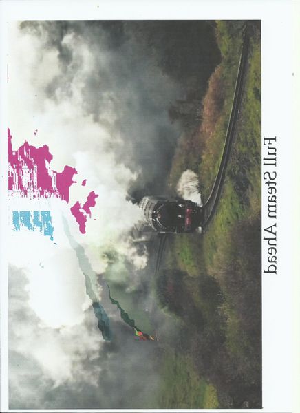

Enclosed attachment shows Ink Transfer, which is not on the original  image.  I have tried several, printings all of which turn out the same.
Can someone explain why please.

Hi Elohl_NR
There is no problem on the copy of this image.
All other print  outs are fine.
I read the document, you referred to, Changed cartridge, (although there appears to be plenty of ink), the new print  out is fine
