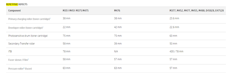

Recently started getting this /sticky\ spot where ink isn't going where it should and then repeating down the page.  Happens with black and color  (shadowed print is on the other side, please disregard)
Is this a roller issue?  Any way to solve it quickly?
1 REPLY 1
If the marks are repetitive (duplicate down the page) measure the distance between to defects and that will tell you what component is causing the problem if you consult a repetitive defect chart. Could be something stuck to the fuser but this engine design does not provide easy viewing of the fuser assembly.
