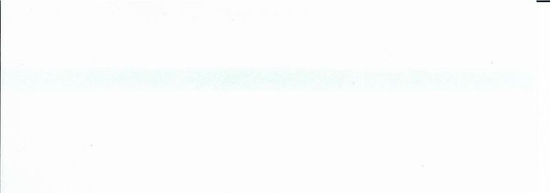

The first issue has to do with print quality. For some reason, I get these horizontal light color lines on the back of the paper. This doesn't happen everytime but the issue is usual. Here you can see what I mean:
cyan color this timecyan color this time
I do not know if you guys can see that. In my screen, it is not very visible, due to it's bad color calibration 🙂

Here are some other photos from the cleaning pages:
Stripes -- all the colorsStripes -- all the colorsLight-Thick stripes cyan and magentaLight-Thick stripes cyan and magentaCyan residue on the top of the pageCyan residue on the top of the pageColor Stripes on the backColor Stripes on the back

And here is what happenes when a color printing takes places. Please note this happens only in the second page. All the other pages are clean.

Now the printer makes even less noise and I got no faded stripes on the back.

Unfortunately, after many days of testing I haven't accomplished the desired result.
I am thinking it may be the fuser roller...

Edit: I would like also to mention that this mainly happens on the first page and very rarely on the second as well
So I just noticed something. If I print from Linux using HPLIP all the pages are printed out clean with no lines or streaks. However when I print from Windows 10 the second page, let's say of a pdf, has lines and streaks. I have the latest firmware installed and I have remove and reinstall all the drivers. Before the reinstallation I even remove the drivers from printmanagement.msc.
