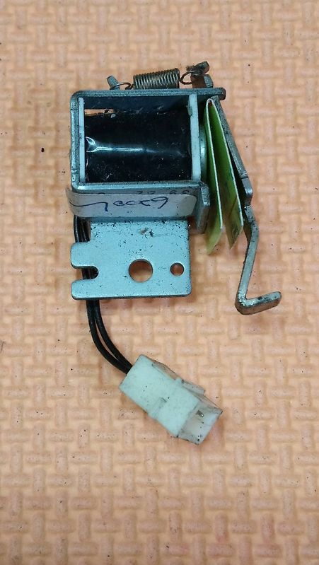

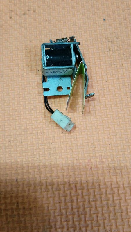

Just use a piece of paper which folded into V-shape and put it in between the two metals of solenoid to keep it from sticky again. It's easy and effective.
