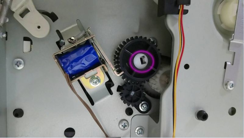

Likely causes are either a cartridge with a drum unit that is too tight or the fuser drive assembly is failing. Does it make the noise even on startup or just when printing? If you have a spare cartridge try that first. If the problem still exists you will likely need to remove the right cover and examine the fuser drive pendulum, if you see gears that are visibly worn or there is lot of plastic dust on that side then that is probably the issue.

I have stripped off the right, left, front, top and back covers to expose the mechanics.
Three pieces of hard plastic fell out. Two are grey and I think are “tabs” or bits of. One is “black” cylindrical and about 13 mm long, 4 mm in diameter with a hole straight through the middle.
Facing the machine, the right side has the gear mechanism. I have examined this side and the gears appear intact with no obvious teeth missing. There is no obvious “dust.”
I have removed the metal plate holding the “central” drive wheel to expose all the others. I have checked them individually and checked for free movement as seems purposeful.
I guess I have already observed the fuser drive pendulum in my first endeavours without knowing what it was.
Since neither of these appear then could it be the gears are “out of mesh.”
The problem arose when I had a paper jam. I do not remember exactly but I would either have pulled the paper out forward or backward. In the process I will have manually rotated the “mechanism.” Has this misaligned the gears. If so -again I have no reference to know where the “start” point is.

07-30-2020 08:19 PM
Base on your word "The problem arose when I had a paper jam. I do not remember exactly but I would either have pulled the paper out forward or backward. In the process I will have manually rotated the “mechanism.”" you probably have three points to check.
1. The couple gear may be broken needed to be replaced.
2. The shaft may be twisted and out of its shape, you can try to twist it back to its way or just replace it. You will have to take the front door off and all the plastic covers out to get to it.
3. There's something dropped into under the paper tray and you'll need to take it out to examine that.
If you find nothing there after your dis-assembly then it should be the shaft out of its shape.
