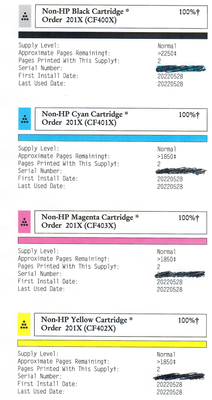

I am having trouble getting my new-to-me printer to print colors correctly. I've downloaded the most up to date drivers. I've changed the settings to various color options (photo, vivid, etc) I've tried adjusting the density. It has genuine OEM toner. The most obvious color discrepancy is with yellow and magenta but I feel all the colors are not as true to what's on my screen vs what prints.

Here are the two requested print outs. I was hoping that the issue was in the toner I was using being low but there's no difference in low HP OEM toner and 2 different brands of new non-OEM toner. I have calibrated multiple times. I've attached 2 examples of what I'm seeing on my screen vs what prints.

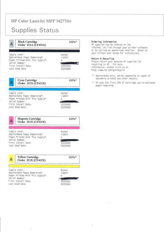

Unfortunately, that didn't solve the problem. I purchased new OEM toner, installed it, ran a cleaning page, calibration and restored all defaults and the print color is still not as appears on my screen. I've attached a copy of the supplies page, an image from my screen, a print out from the HP and a print out from my inkjet. Note the color differences, particularly in the face of the little girl. The yellow/browns tones aren't printing correctly.
Screen ImageScreen ImageHP ImageHP ImageInkjet ImageInkjet ImageToday's supplies status pageToday's supplies status page
The accessory status page looks very good. In fact, the printout deviates a lot!

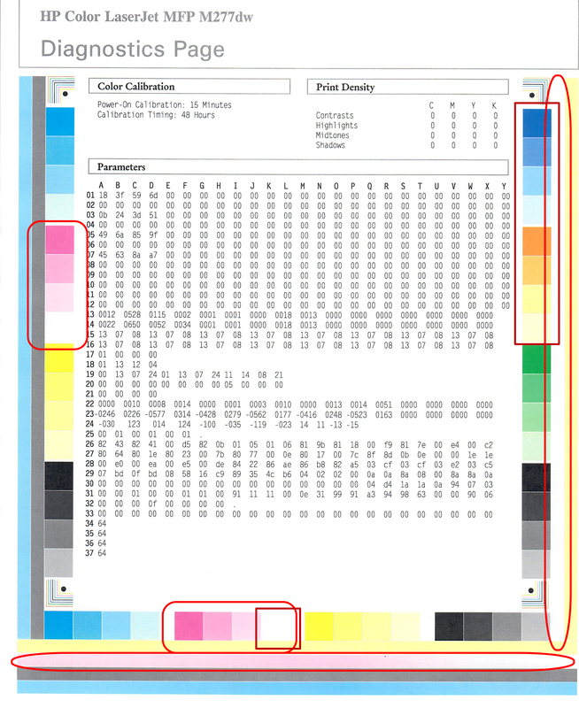

Thank you for helping! I've tried everything I could think of to correct this issue and was beginning to think it was a lost cause. I appreciate any insight you are able to provide. Here's the diagnostic page requested...Diagnostic.jpeg
The Magenta cartridge is defective!

Print the diagnostics page.
The diagnostic page should then look like this:
If nothing has changed, then the magenta cartridge must be reclaimed. Please attach the diagnostic page and also the supplies status page (latest printout).
