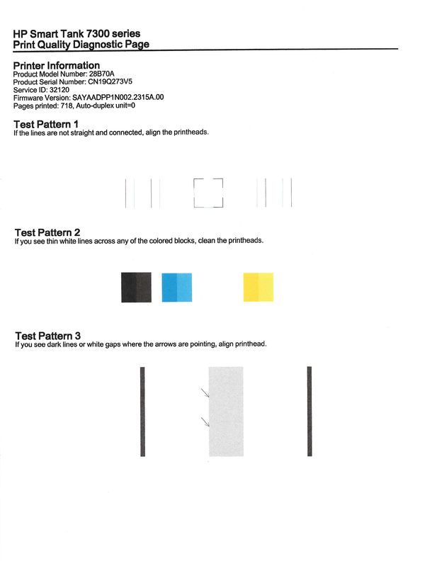

This printer recently stopped using the magenta while printing. I ran a "Print Quality Diagnostic Page" Test Pattern 2 shows colored blocks in black, blue, yellow. The block that should be the magenta is blank. I have run 'clean print heads' several time. Same result. I have run align heads several time as well. Same result. HP Smart shows all tanks full. And I can see the level of all colors, and they are all 3/4 full.

While you respond to that, let's print a Print Quality Diagnostic page -Post the Print Quality Diagnostic page here so we can help you further.

  • HP Smart Tank 7300 Series
  • Print Quality Diagnostic Page
  • Printer Information
  • Product Model # 28B70A
  • Product Serial # CN19Q273V5
  • Service ID 32120
  • Firmware Version SAYAADPP1N002.2315A.00
