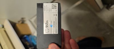

 I try to replace 3 new inks but the printer don't work, see note above.
When I reinstall the old one I get this massage:
  the problem is because the age of the inks? Thay new...

Check for Cartridge Compatibility
  • Confirm that the cartridges match the printer’s supported model. For example, if your printer uses HP 951XL cartridges, ensure they are not expired or third-party refills that may lack chip recognition.
