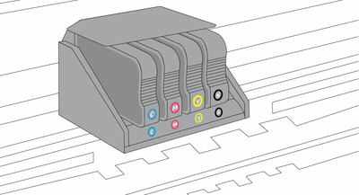

Remove and reinsert the ink cartridges
Make sure the cartridges are seated properly in the carriage.
  1. Turn on the printer, and then open the door or lid to the cartridge access area.
  2. Wait until the carriage is idle and silent before you continue.
  3. Push the ink cartridge to remove it, and then push it into its slot until it snaps into place.
    Removing and reinserting the cartridge
  4. Repeat these steps to remove and reinsert the other cartridges.
  5. Close the door or lid to the cartridge access area.
