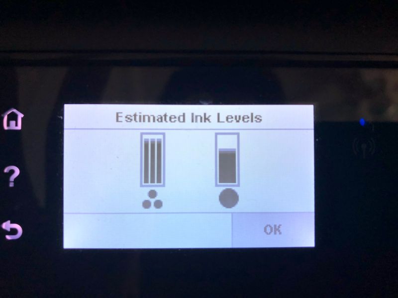

My printer is not printing reds. I did all the cleaning prompts, and inserted brand new HP black & tri-color cartridges. Printer screen is showing full levels. No luck.IMG_5123.jpegIMG_5124.jpegIMG_5125.jpegIMG_5126.jpegIMG_5122.jpeg
