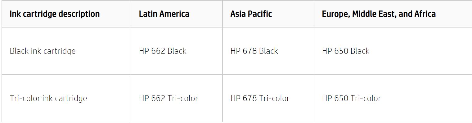

I have strange issue with my hp 3545 printer . Suddenly printer is showing catridge not intended to use in this printer .So after lot of research i found that i will require reset code to fix it. given below is my printer specification

Can you help me with changing the region on my HP Deskjet 3545 printer. I can only get hold of 650 cartridges and the printer came originally with 678 which I can't get anywhere. I really need this printer to work for me. Thanks in advance for any help

Here is the list of cartridges that you can use in your region:-

Yes had the printer in UAE and now moved back to UK.
Yes was in UAE and not moved back to UK. do I need a code to change the region?
@JUSTKIT
We need to perform a regional reset on the printer to resolve this issue. 
The reset instructions are specific for your printer and performing those steps on a different printer may brick the device. 
I've sent you a private message with reset instructions, follow the reset instruction to perform a full reset and re-initialize the printer. 
