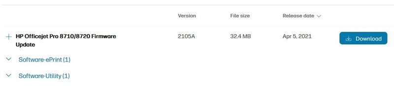

Thanks for responding, Alden.
  • I performed a hard reset per the steps you described, with no success.
2024-01-09 14_06_06-HP OfficeJet Pro 8720 All-in-One Printer Software and Driver Downloads _ HP® Sup.jpg
  • I received the following message after installing the executable. I presume this means that I have the latest firmware.

I should have mentioned that the message is grayed out, and the checkbox is not select-able.
Also, I've done all the other steps you described in your message.
I'm not sure why this image keeps failing to load. Let's try it again:
