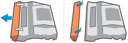

Prepare the new imaging drum: Remove the new imaging drum from its packaging. Remove the orange cover and the tabs from the new imaging drum. Removing the drum cover and tabs

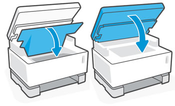

Close the top cover and lower the scanner: Closing the top cover and lowering the scanner
