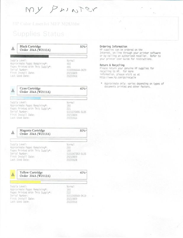

mfp m283fdw very light printing, i use printer assistant and print a test page but I don't know what i should be seeing.  I see a yellow rectangle then some space then a black then a grey rectangle
shouldn't i see all the colors. does anyone have a picture of what it should look like.

Thanks for the response, I was waiting to gather more info before I responded.
Here is what the supplies status report looks like on my  printer.
The black and cyan are light and the magenta shows no color at all.

So, I have light printing and the magenta not working at all  and it doesn't appear to be the toner cartridge, any suggestions?
This printer is about a year and a half old.  If you look at the black usage the printer hasn't even printed a ream of paper yet.
