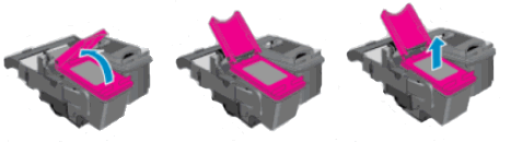

    • Carriages with cartridge latches: Open the latch, and then pull the cartridge up and out of the slot.
      Removing the ink cartridges with latches from the carriage
