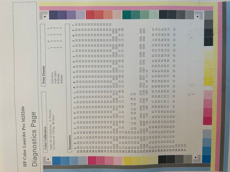

While you respond to that, let's print a Print Quality Diagnostic page -Post the Print Quality Diagnostic page here so we can help you further.

Sample document with ghostingSample document with ghostingIMG_8857.jpegIMG_8859.jpegIMG_8858.jpeg
