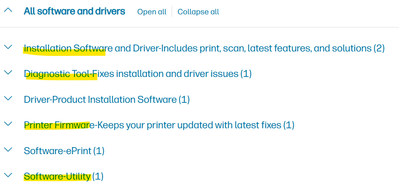

I downloaded the drivers and software highlighted by yellow in the image below from the web site of HP Deskjet 3630 series and installed them on my computer.
