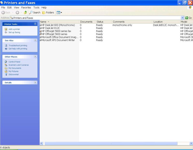

I have an HP OfficeJet 5610. It is connected to my old XP computer and shared.
How do I configure WIn11 to print to it? It is shared on the computer Slickswintel as HPOJ5600

I am obviously doing something wrong with the setup. I have a laptop that I somehow managed to get to print to the printer 2 years ago. I noticed that the ports look different on the laptop than on the desktop, but I don't know how to fix it or what procedure I used to get it working.
On the laptop with Win11, the port properties look like they are printing to a USB port. It is also followed by a seemingly unused DOT4_001 port. My old Vista/Windows 7 computer looks identical, and it looks the same under Vista (it's a dual-boot computer I got in early 2009, I don't use Vista much these days).
On the Win11 desktop it looks a little different which suggests there is something wrong with my install/setup procedure.
Any idea what I'm dong wrong to set this up? What procedure I should use to connect to and use the printer shared by Windows XP?
I have SMB1 and SMB direct turned on in "Turn Windows Features on or off". I can access the XP files just fine. The printer shows up, but I can't open it either.
I also tried starting over after turning Windows Firewall off and rebooting just in case that was the problem. NO effect.
