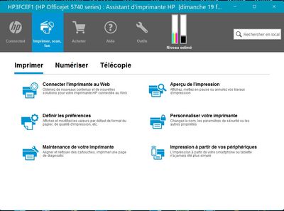

A printer menu appears (See below) with "ink levels", possibility : print, scan, fax, numériser.
If it works, you can delete the old shortcut on the Windows desktop.
