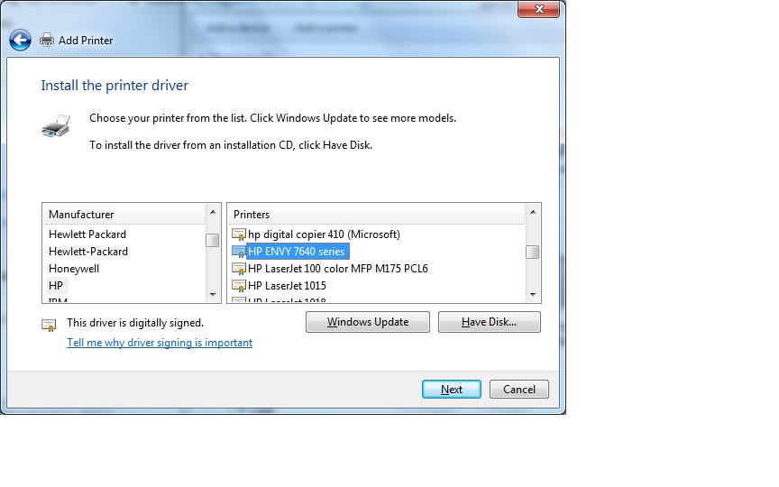

Then it would give you a lot of printer drivers to select from.
On the bottom of this screen, you will have an option, to click on Windows update. Please click on it.
This should install the correct printer driver for your printer and will resolve the concern you are facing.

Hallo Chimney_83,
thanky a lot for your fast response! I tried what you suggested but when I pushed on the "Windows update" - button I got a long list of printer-drivers but a "ENVY 4524" was not listed, only a "ENVY 7640". I tried this printer but got the same results (crash in hpygidudm.dll).Please advise what I could do next.
Andreas
