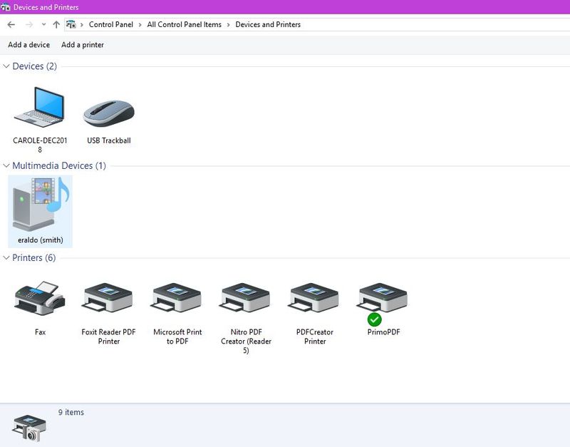

HP2545 is grayed out in Devices and PrintersHP2545 is grayed out in Devices and Printers

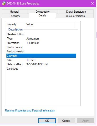

20190913c Pic showing Full Feature Driver File Version and Size
20190913c Pic showing Full Feature Driver File Version and Size20190913c Pic showing Full Feature Driver File Version and Size

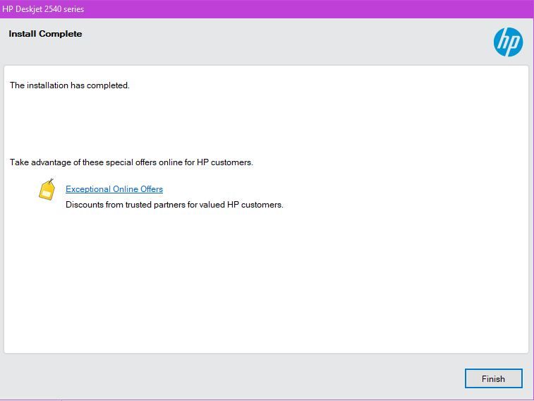

20190913f Pic showing items as they are being installed by Full Feature Driver Software
20190913f Pic showing items as they are being installed by Full Feature Driver Software20190913f Pic showing items as they are being installed by Full Feature Driver Software
20190913g Pic showing Full Feature Driver Software as it finished the installation
20190913g Pic showing Full Feature Driver Software as it finished the installation20190913g Pic showing Full Feature Driver Software as it finished the installation
20190913h Pic showing Devices and Printers after install but printer is not there
20190913h Pic showing Devices and Printers after install but printer is not there20190913h Pic showing Devices and Printers after install but printer is not there

Eraldo's computer shows up as a multimedia device but is grayed out.Eraldo's computer shows up as a multimedia device but is grayed out.
I hadn't deleted it in case he still had problems and needed to bring it back to me. Then yesterday, I decided after this length of time it was fixed and I clicked on it and said Remove Device.  Then just on a hunch, I turned the printer back on and went through a Full Feature Install and voila, it started working.
Then I did a bit more research and found that routers and/or hotspot routers, which I have to use, have limits as to the number of devices installed.  I had no idea that was the case.  I would have thought it would have been limited to the devices that were in actual active use, but evidently not.  This was one of those happy accidents because I would never have thought of this.
