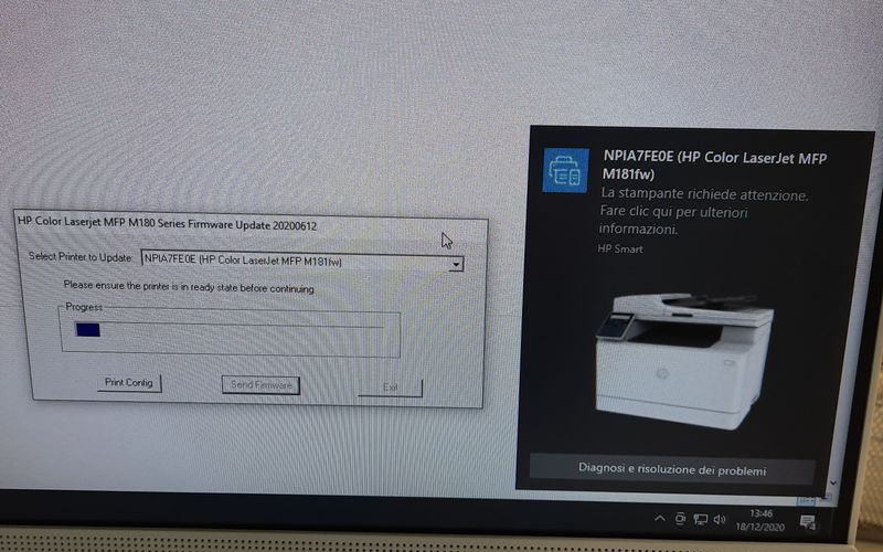

I understand  where is the problem:
when I run the executable file a message tell me that the printer must be in "ready" state,..
but mine has exceptions due to non-original toners and therefore the installation does not even start firmware.
Another window message appears, with a generic warning....
ErrorError
No messaage "installing...."  appears on the printer...
It's like a dog chasing its tail ...
please, help!!

HI I want you to help me downgrade my hp color laserjet pro m181 printer firmware, I download  the actual m181 firmware but dint work how to get the right firmware for my hp color laserjet pro m181 printer firmware software.
You have to do the following:
– Find on the web the following .exe file: HP_Color_LaserJet_Pro_M254_dw_Printer_series_20200612.exe (if you dont find it send me a mail and I can send it to you)
– Remove the cartidges from the printer
– In the printer setup menu, find the service menu and surf inside to set ON to downgrade, and to receive updates.
– Be sure that the printer is connected to the same network that your computer
– Run the .exe
– Reboot the printer
– Check on the printer service menu the firmware version, should say 20200612
– On the printer service menu, turn OFF all the update options
– Install the non-HP cartidges and you should be all set.
