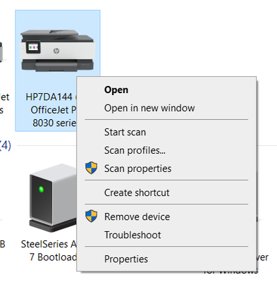

Thanks, but it doesn't ask me to install drivers. It tries to automatically install drivers but fails after about 10 minutes of being stuck.

There is no printer properties.
