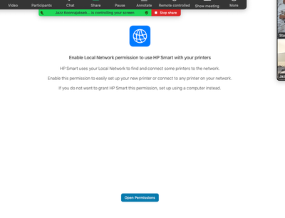

Been trying to enable HP Smart app on the Local Network in the Privacy & Security in macOS Sequoia 15.3.1. But it doesn't show up to toggle it on.
I've tried almost everything. Any advice would be greatly appreciated.

I've tried to uninstall and reinstall the HP Smart app. Tried to add the printer manually with the IP address with every protocol.
I get an error message when I try to add it through Air Print. I reset the printer network configuration.

HP Smart App Permissions:
Go to System Settings > Privacy & Security.
Scroll down to the Local Network section and make sure HP Smart is listed and checked.
If it's not listed, try opening the HP Smart app and connecting to the printer again. It should prompt macOS for permission.
