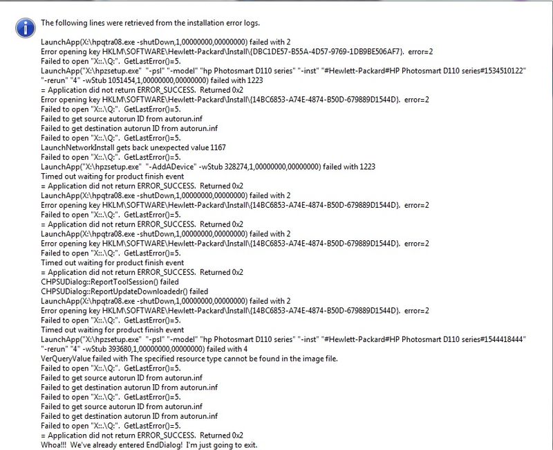

I have an HP printer D110 that prints wirelessly from my tablet and my phone, but does not print or scan from my laptop windows 7 (64-bit).  After uninstalling and re-installing from the original CD and unistalling again to install it  from the software downloaded from HP website, the same error shows up:

I followed every step you recommended. However, the installation process does not recognize my device is connected via USB. When I try a wireless connection with a disconnected VPN, a dialogue box shows up advising the printer could no be found on my wireless network. I ran HP print and Scan Doctor 5.1 with the usb cable connected and it printed a test page.
 Any idea?
